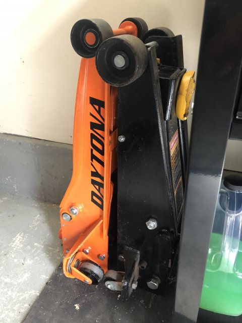

Will storing hydraulic floor jacks vertically cause them to leak?
2,538
6,985
Something like this:

I'm not sure. I've always left mine horizontal
10,164
28,240
Shouldn't?
2,538
6,985
I snugged down the valve and they seem ok. Ill check them when I get home.

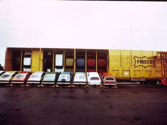

Since I or most I am guessing have never seen it done I am guessing it is not a good idea?i think it was the Chevy Vega that was shipped vertical. Don’t think it was ever done again?
10,164
28,240
Have not heard that before.

The only problem with doing that, is that the jack mechanism has a vent on the oil reservoir. either in the fill plug or elsewhere. And when turned up end wise. It can leak oil out of the vent hole. Just like anything else that has oil in it. it is made to function in a certain orientation.
2,538
6,985
Just checked them for leakage, so far so good.

Pit Pal Products makes a floor jack holder that mounts to the walls of trailers to hold jacks in that position.
20,157
Vega verta pack
Amongst other things engineers designed an engine oil baffle to prevent oil from entering the No. 1 cylinder, batteries with filler caps located high up on the rear of the case to stop acid spills; carburetor float bowls with a tube that drained gasoline into the vapor canister during shipment, and a windshield washer bottle with a 45 degree angle.
10,164
28,240
Vega verta pack
All the extra design, just to save on shipping.
Wow.

I’ve stored jacks vertically long term with no issues but was opposite direction, large wheels down, pump up

Vega verta pack
Damn I was right! My memory is still good.
