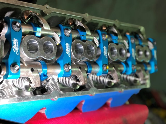

here is where we are going. Jon and me sat back and did some thinking ( Bad Idea ). How can we get the car to hook on any track or street and be able to control that power better. Came up with my car needs to be lighter. It’s 4700 pounds. So I talk to Bruce and we come back with a block with take some weight off the nose. So now on the way is an Aluminum Block from Bruce at HHP.
now we sit and been talking for a bit about changing to a turbo. Back and forth we go for I would say a couple months than this past Saturday Jon sends me a screenshot of Alex at Peitz Performance starting a turbo kit. Log and short I know Alex very well and he was out of the hellcat game and moved to C8 vettes so I call my dear friend and say what’s up with this.
So long and short we are now using my car as the test pig for this kit.
Dave comes in as a HP90 will have to hold up.
I will post pictures as things go and will still be selling parts.
as you can see it’s going to be a top notch build
It’s going to be a 426 ci
Aluminum block
Windburg crank
Oliver rods 625 rod bolts
Thiteck heads titanium valves
Diamond pistons
Steve Morris cam
Daves HP90 extreme
turbo kit will be 6466’s twin intercoolers air to water
Everything will be perfectly fitted and tuned look at parts so far. This will be the replacement for whipples
Rear end will be a TBA billet diff with a wave trac.
Overall we should loose 300 pounds and have boost control to the moon.

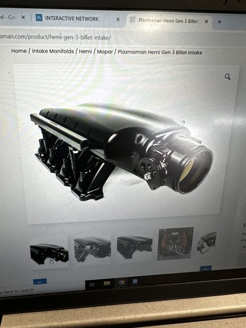

Any pics on that alum. 426 block? I too have a Plazmaman intake. Not cheap but beautiful to look at. Problem we had with it is there is no place for the MAP sensor so you'll need to custom fab a place for that. Also no breather for crankcase ventilation or place to add oil. Had to get new CNC rocker covers with venting and oil access. The stock rubber gaskets/seals are too small and now get some air leaks around the intake runners. Car runs like crap right now. Found fatter rubber seals that will be replacing the stock ones soon.
Also have a Hellcat throttle body which will not fit. Had to CNC a custom adapter plate.
I used it for an N/A application. Prob. not the most efficient use of the thing but just couldn’t help myself.

Block will be here sometime next week.
I have the full Manton rocker set up with his covers for crank case breather system.

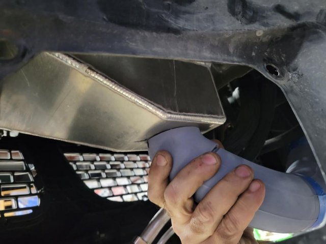

Thread Starter #20

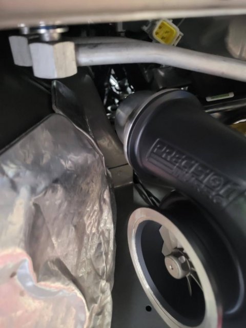

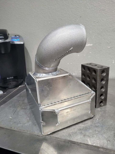

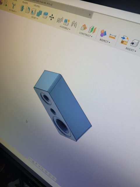

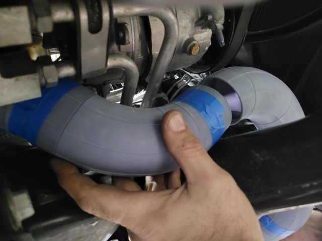

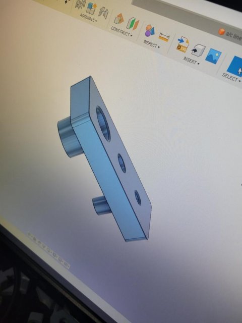

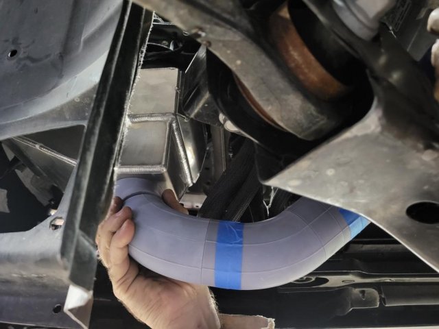

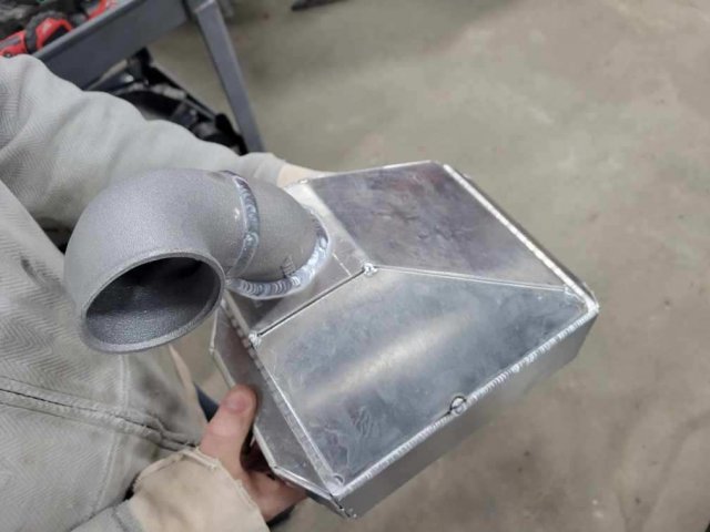

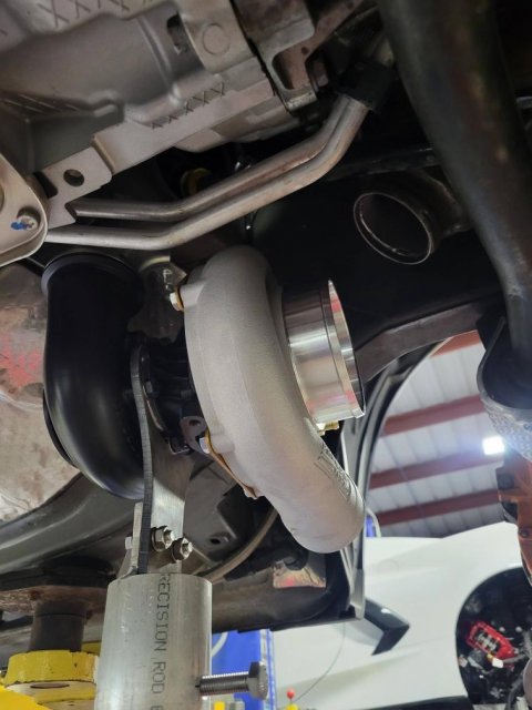

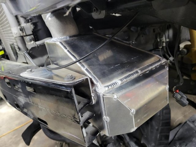

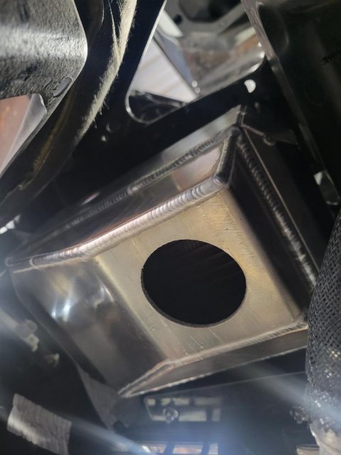

Here is some more updates from Peitz Performance. Making it where a factory chiller on a Redeye will still function Resized_20231102_183340.jpeg Resized_20231102_183346.jpeg Resized_20231102_183356.jpeg Resized_20231102_183408.jpeg Resized_20231101_181643.jpeg Resized_20231101_181855.jpeg Resized_20231101_181848.jpeg
