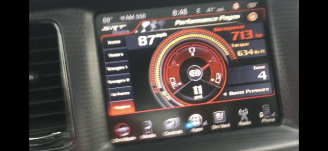

645-648hp, that's about right, RWHP. I don't think you'd ever get 707HP to show.

Boost should be 11. But depending on other factors it could be 10. If you are seeing less than 10 and aren’t at high altitudes you have a problem. Do you know anyone with a hp tuners device or a Diablo ? If you should datalog you would see all the info you are looking for.
you car does not have to be tuned or unlocked to datalog.
I don’t think I’d put much trust in the hp gauge on these things.
yes if your MAT / iat are high enough it could pull 50 hp. Also any sort knock retard could could take 50hp away.
also we have seen air quality make a difference (da). Some cars go almost a half second faster in the 1/4 mile. 3000da to 0da could be as much as 3/10ths knocked off the time.
but you don’t normally drive at 0 da.

I only saw 11psi on my gauge and in excess of 700hp one time, and it was 41*F… and the snow tires I was on were not happy about it.
I never really thought there was anything wrong with the car, there was never any excessive belt residue if it was slipping, and I ran a 10.9 at almost 5000lbs of race weight in positive DA.
Saying all of that to say that the gauge works, but I wouldn’t rely on it for much of anything. Track times and logs are the best indicators that something is different. If it’s noticeably sluggish… without a CEL the dealer won’t do anything for you other than happily joyride the piss out of your car to see if they feel the same way.
2nd gear comes and goes too quickly… try 3rd or 4th and let her build up some steam. For this pull I let the car downshift from 5th to 3rd and then into 4th… that all happened in about 1 second.

also look at iat on your dash if possible.
look at the temp before you hit it and after the pull. Hold on tight while looking at boost. Being a manual you will have your hands full.
iat temps (technically MAT) can pull around 10 degrees of timing if to hot.
only thing we won’t be able to monitor like this is your knock sensors.

Bad fuel. It must take a while for the car to "reset" it self. Ma has been dailey driving to School this week since I traded her R/T for the 12v diesel. We took her out today( when I found reverse) and I noticed the 50hp right away gauge showed 696 boost was 10psi
4,385
10,911
If Ltkr happened then it would take a long time to get rid of those. Also these tanks are hard to get all of the fuel out with the way the tanks are.
