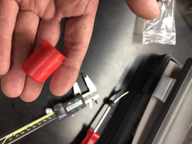

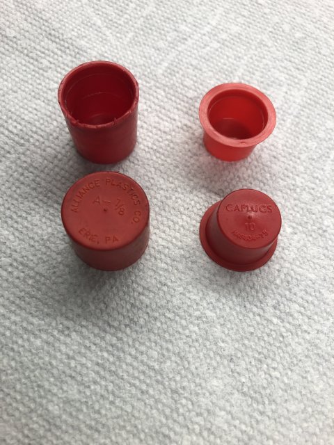

what size are those plugs? I’d love to plug mine as well since I’ll definitely be taking the supercharger and putting it on my work bench.
from what i can see, the plug in the left is 7/8, what size is the one on the right? Same size?
3,322
7,856
Don’t know, they come off pipe and hydraulic fittings and such, I save all kinds of caps in a bag, I cap the injector inlets as well to keep crap out of them. They say 10 on them, I assume from a 5/8” fitting. They taper from from .750” to .850” OD, the caps ID is .785”, hope that helps. They fit inside on another as well image.jpg
