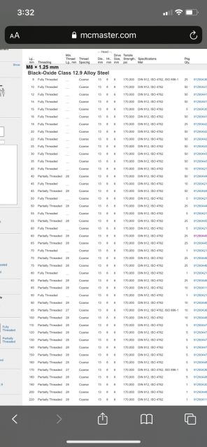

Was looking for some bolts to go with the FI Spacers and can’t find a ton of info online or options. Wanted to see if the 200mm ones listed here would work

I was more looking to make sure that the threads are correct, head diameter is wide enough and other specification are in line with what FI sends. I guess does anyone have the exact specifications that their bolts are?

So the stock ones to the top of the head are 200 mm
The head of the bolts is 7 mm
That 91290A484 could be what comes with the spacers. $2.41 isn't to bad
I was looking around to see if there was anything else and didn't see anything. Other option would be the 220 and cut them down if need be. You only have 28mm of thread but depending on how deep they can go may actually get more thread in them
I was hoping maybe I stumbled across what they use. The heads on these show 13mm? Does that sound about right?

They appear to be about the same height as the stock ones 7mm

You will need a 205mm bolt, to maintain OE thread depth, if that is your concern. Also, bolt length is generally measured as the shank and does not typically include the head.

Like I said to OP he could go longer and cut them down. I do not know how deep the holes go so he may not have to cut any off or very little
