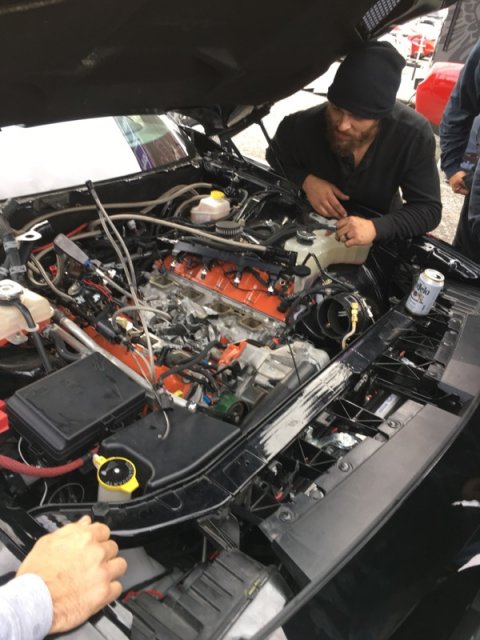

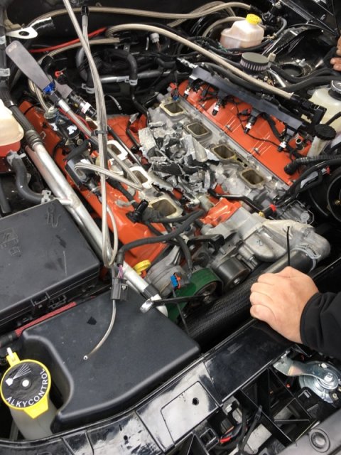

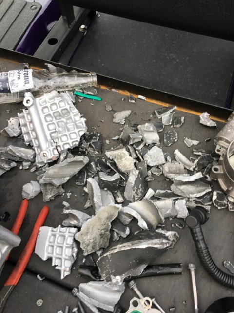

Here are a couple of pics from a Nitros Express user. This is what happens when forgetting to turn the NOS OFF during a burnout!

Of course it is.....that's just a few pics there are more times!
4,715
33,231
Small shots of NOS around 150 shot seem to do fine for quite a while.
Lots of Superchargers have gone Kaboom from using bigger shots after a while.
