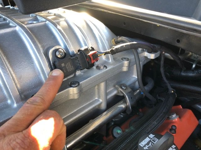

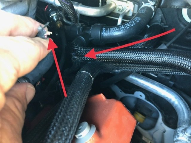

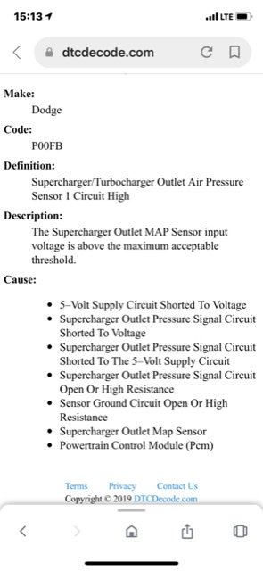

My friend Pulled a P-00FB CODE. How the heck could these wires possibly get cut like this? Absolutely no one has been under his hood lately. 🤦🏽‍♂️
can these wires be soldered without creating another code.
Any help appreciated.

You can solder those wires back together, without issue. Be sure to use waterproof heat shrink, on each joint.

Vermin damage?

Mice?

If I'm not mistaken the push pin that holds that wire to the s/c lid is suppose to be under the lid & not on top.
Mine is under the lid anyway. Not what caused the cuts but may be to tight the way you have it ?

My Redeye is on the top and my Hellcat is on the bottom. He did repair them with no issues.
