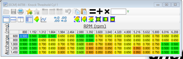

Also of note is how low the factory thresholds actually are in the knock sensor tables. It's a 0-5V sensor for reference.
