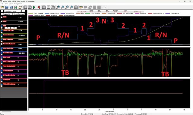

Thread Starter #645
Still getting jiggy with it. Might have a private rental on Monday
Holley has a new transmission ICF I am learning to tune.
