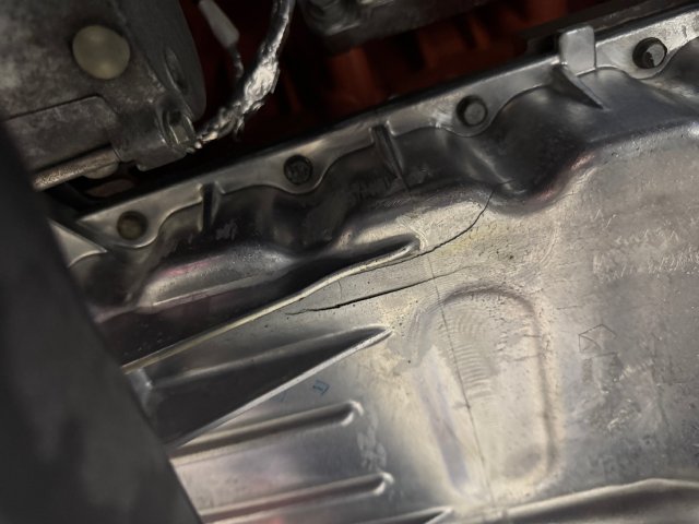

Crack in the pan can be welded at least.

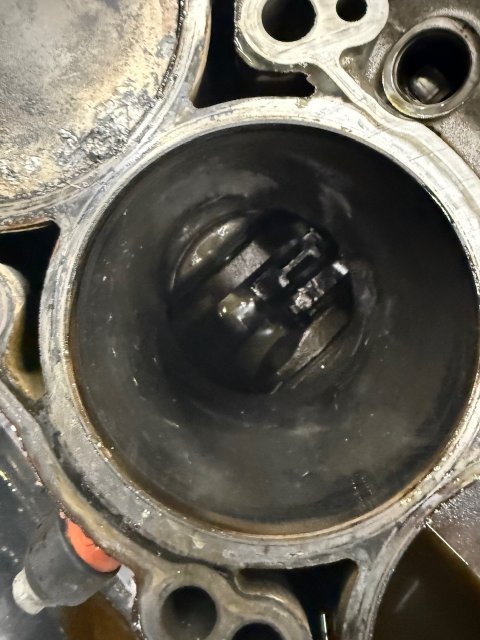

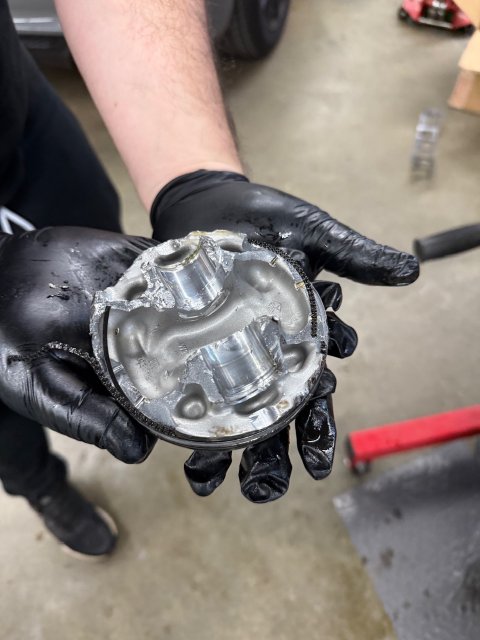

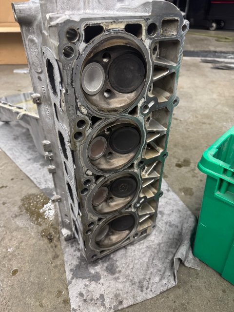

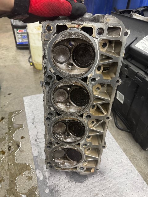

Cylinder six and five need sleeves. Crank should be save able, machine shop will determine if so. Thank y’all for 2024. 2025 is going to have a lot of free time 😅

Should I be surprised it broke rods at 820rwhp? I mean the torque was sky high so maybe that's the deal?
8,742
7,676
8,742
7,676
I was wondering about the torque too but thought maybe that was due to the hub dyno
4,129
10,396
Thread Starter #698
The issue was in the tune supposedly. It went lean and it wasnt happy. I will be making a video soon of some of the downfalls of letting Holley choose sometimes.
