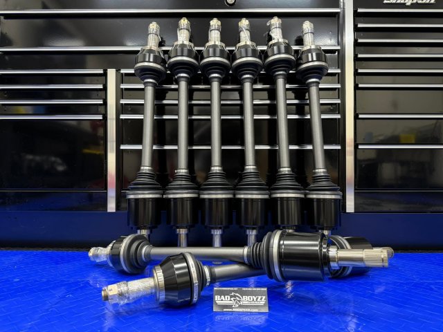

#12838
347
1,222
Martin
2018 Dodge Challenger Hellcat
https://mooredperformance.com/produ...hallenger-charger?_pos=1&_sid=f4d2f0938&_ss=r
Bad boyzz
BBGSPEED HellCat Billet Series 4340 / 300M CV Competition Axles
Race Proven!
Due to high demand from our customers and Dealer Network we are currently machining a new 60 set production run after our 1st 50 set machine run sold out! We appreciate everyone’s support and now offer a lifetime warranty on your purchase
Don’t miss this production run and secure your set today!
Retail $3,295.00
Racer $2,999.00
Shipping August
(1) Specifications
:Outboard Billet CV
:Solid 1-Piece Design
:4340 Billet
:Cage 300m
:Race 300m
:Severe Duty
:Axles 300M Billet
:35 Dana Spline
:1.5” Diameter
:precision Gundrilled
:Severe Duty
:Inboard Billet CV
:4340 Billet
:Cage 300m
:Race 300m
:Severe Duty
(2) XP Heat Treatment Technology
:Billet Copper Core
:Increased Rockwell
:Hardened Bearing Race
:promotes Severe Duty-use
:promotes Longevity
(3) High Temp Synthetic CV Racing Grease
:Shock Protection
:Cooler Running
(4) Powder Coated
:High Performance Spec
:High Heat Resistant
(5) Lifetime Warranty
(6) Fitment
:HellCat
:Redeye
:Demon
:Scat Pack

It was decided to move away from the polished nickle as the new designs heat treatment process is a crazy process and strength was decided on over looks.

Thnx for the support Jonathan Moored who btw is a stocking dealer as well. Yes we’re holding up well and have a solid track record to date. Our billet 4340 1-piece design CV’s w/300M internals and 35 spline Large diameter 1.5 gun-drilled Dana axles was the only way to go in our opinion. Our patent pending XP Heat Treatment and Coper Core process allows us to increase the Hardness (Rockwell) of our bearing races for severe duty use and longevity of our axels.
Pic below is Sipple’s 7 second Beast putting power to the ground with a set of axles🇺🇸
We have a great customer base, solid dealer network and offer a tech line for your questions and installation help and offer a lifetime warranty on axles🇺🇸
