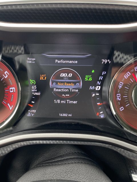

I just bought my Challenge hellcat wide body. I was going thru the best times stored on the cars memory and the guy before me has the best 1/8 mile in 5.4 sec. how is that even possible. I bought it all stock. I think he did do something with the exhaust but he put it back to factory when he sold it.

An extended burnout might explain it.

100% makes sense, while you're at it if the top speed says 202 it is a burnout for sure. Otherwise you have one of the quickest hellcats ever.

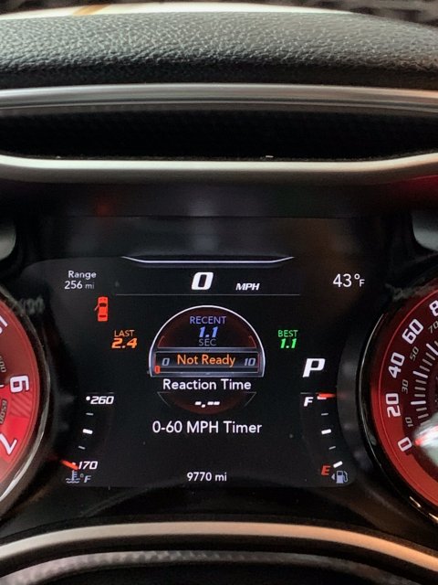

I dont trust those timers at all. My car has a 0.7 0-60 and a 1.0 0-100

That is possible because the previous owner did not know how to reset the timers after he did burnouts. Definitely a burnout time. It won’t do five second 1/8th’s. A smoky one busts up the 0-60 and the 1/8 mile easy.
RESET IT AND START OVER.

Most timers do not use the rear wheels. I would think the timers are done by GPS

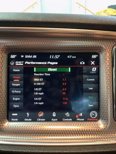

It is the rear wheels. It uses those “tone rings” that are a PIA when you blow an axle. Last fall I smoked a racing set of tires one morning. Had to reset the timers, it really screws them up. The 1/4 mile held correct because I did not burn 1/4 mile worth of rubber. I won’t do it again.
