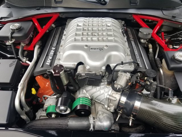

2.65 upper with factory lower adding BWoody anti slip...What belt size?

As the title says...can anyone chime in?

Thank you...I called and spoke to her. She provided a chart that was kind of useless and we were kind of at a guessing point. I went with the Gates K100572HD and it worked just fine. I have driven almost 800 miles so far and no problems.

You need to check that it holds under boost of boost fall off at high rpm then the belts slipping and the position of your tensioner will also help you to be able to tell if you need a shorter belt

Boost is holding up beautifully...I originally had the same belt and after approx 15k miles I started to get belt slippage at 4-4.5k rpm shifts. I purchased the BWoody Anti-Slip idler Pulley V2 off a member here and purchased a brand new belt from Gates. I had my Tech at my dealer install it. We were a bit hesitant but after installing it and he checking the play he said I was good. I havent had any issues so far and holds boost at 17psi.

Left side approx 15k miles Right side brand new.

You have the bwoody tensioner
Do you like it

Looks good
Do you like it
yeah I do....the I still went smooth and more important it holds boost
