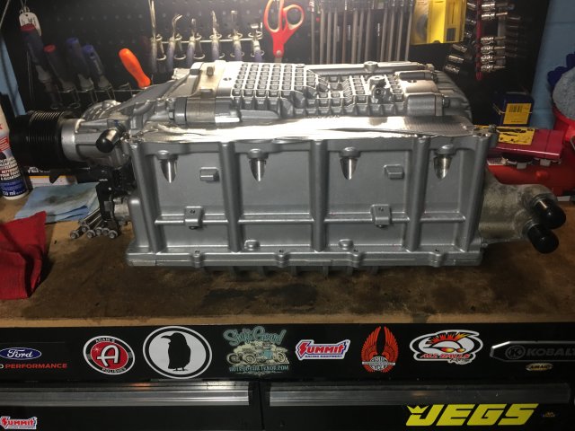

Meancat, was it you who bought longer dowels to put on the supercharger after installing the spacers?
if so, how did you get the OEM dowels out???
I used vise grips and I can get them to spin in the hole but they won’t come out !!!

Their a fu*cker to get out, I had to heat the boss with a torch and keep working the pin back and forth until it freed up then wack the vise grips down with a hammer while spinning the pin back and forth. wasn’t much left of them when done, was a real BIT*CH!! I’ve done 5 or 6 of these for guys and EVERY ONE was the same way, like a damn hour on 2 pins :(
Aaaahhhh, it was you !! I’m all over the place trying to get ideas on how to remove them. I asked a couple of guys (I think on the other forum).
im searching all over the place so Im a little confused of who I asked and which forum I asked the question in hahaha.
I got one of the dowels to spin fairly easily by using vice grips and a long metal pipe for leverage. It wouldnt come out so I stopped working on that so that I could go back to the car and clean up all the IC coolant I spilled on the motor/wiring harness while removing the lines.
I’ll get back to the dowels tomorrow. I’m gonna do my best to do it without heat. My level of finesse is not all that high so I don’t want to mess with fire unless I absolutely have to.
thank you for offering more info on removing them.

halfway done with my install, took me all day yesterday to get the blower off the car.
Now I’m gonna take time to wrestle with the dowels and clean up the bottom of the blower beforebi apply the spacers and blanket.

My son just talked to someone from litens "the pulley manufacture" and was told to not use spacers. They change the geometry of the supercharger pulley.
I don't understand how that could be.
Has anyone heard of pulley failure because of spacers ?
Has anyone with spacers had a pulley failure?
Someone on the old forum mentioned the same thing to me. They said the spacers change the geometry of the belt. In theory that is correct, but the change is on the same plane meaning youre only adding elevation to the geometry.
as long as the supercharger is installed in the same exact spot as it was originally (by replacing the dowels with longer ones) you should be ok.
Sorry I'm late , looks like you have it figured out about now , I didn't pull my dowels out , don't think it's need unless your going pro mod. :)

All good mean cat Thank you for replying.
I was able to pull my dowels out today, first one came out fairly easy by by spinning it with vice grips then taping the vice grips with a hammer.
the second one was a completely different story !!! It seemed like it was frozen in place somehow (Probably due to the heat cycles, my car has 12,000 miles on it). tried to twist it with the vice grips and it wouldn’t budge, the vice grips kept chewing it up. I had to drill it out ! Talk about nerve wrecking, it was not fun drilling into a blind aluminum hole on the supercharger !! took my time, drilled out a smidge and check, drill out another smidge and re-check. Over and over and over. Finally the dowel got thing enough where I was able to tap it with a punch, get it to spin inside the hole and then pull it out.
I feel like after lifting and removing the supercharger off the motor, taking these dowels out is the hardest part of this job. I’ve heard replacing the supercharger belt is not picnic.
