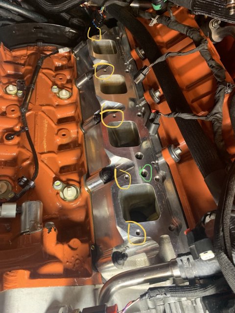

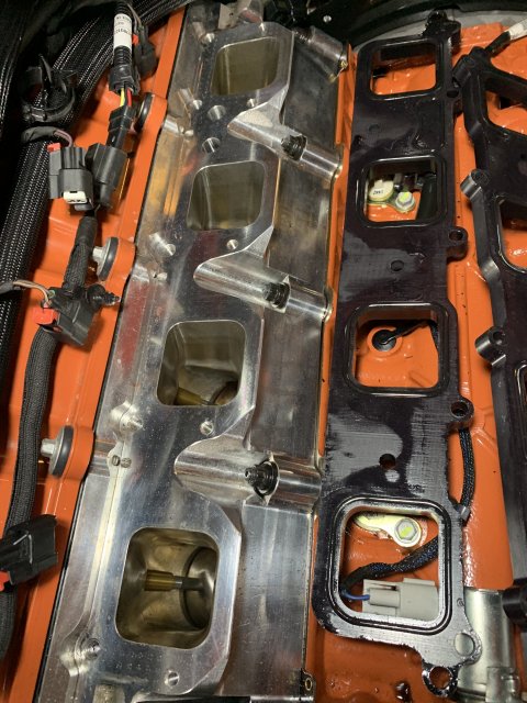

I had a similar issue, oil pooling in the valley. It turns out that some bolt holes provisioned for non-Hellcat manifolds on the Thiteks breach into oil filled spaces. The solution is to plug and seal these holes up. I used 6mm set screws with thread sealant and then I purchased a set of cometic intake gaskets since they mostly cover these holes. The cometic gaskets are probably not necessary if the holes are plugged properly but that’s what I did.
I tried the spacers before I figured out where the oil was really coming from. Take notice of where the oil is collecting. Outside of the intake port gaskets!
I circled the holes that need to be plugged in yellow. If you shine a light in the green circled oil galley, it’ll shine through and be visible through the nearest yellow hole.

I had to pull the whipple off twice myself before I figured it out. Craig from Thitek is aware and has been socializing this but a lot of shops out there are not in the know.
3,497
11,252
Ok. Thanks. This is a tremendous help. Those spacers only seal inside their O-ring boundaries and if those other holes are pushing oil then that explains everything. In the valley is exactly where we are getting it and that has to be it. We’re thinking it’s the spacers and are half right. The spacers and the Thiteks. One last question.... on the Thiteks, has there been any issue with the two holes fitting inside the dog bone shaped O-ring on the spacers? Just wondering about the fit there due to the obvious fact that those spacers are not made with Thiteks in mind. Have you continued to use the spacers or chuck them and just go with the plugs and Cometic gaskets?
I chucked the spacers and went with cometics.
Zero oil in the valley since, thank goodness. That took me several weeks to chase down myself.
