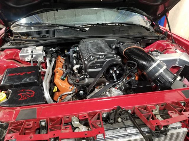

Update on the build for anyone who cares haha. Got the motor and transmission in today one more weekend and we should be able to fire it up. The headers were the way to go for sure. Im so excited!!
Still have the 15 inch conversion, aad drag suspension, nitrous, cage and some odds and ends after that. 20220305_183141.jpg 20220305_183149.jpg
3,630
11,710
A couple suggestions. I’m assuming you are E85/90 with this. The combination I ran when I had the 4.5 Whipple on mine was the 4” pulley with the +10 ATI lower. The ID1700 injectors with the Fore triple pump worked well. I recommend the heavy spring billet belt tensioner to control the belt with that combination. That combination is easily capable of 1200+whp. Also (top secret) turn your throttle body upside down. Pic attached. 🤫 52238BD3-0AE8-452A-BFF1-B4EB1F360AC5.jpeg
