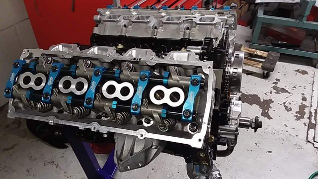

It’s been a long 4 months but the car is nearing completion. For those that didn’t see my thread in the other forum, my stock blower grenaded and shrapnel took out my motor with it.
My initial intent was to rebuild the stock motor but after a lot of time, thought and some opportunity, it became sort of an all-out build. Here are some of the details:
ENGINE:
-426 stroker (technically 428)
-Molnar Crank
-Molnar Pwr Adder Rods
-Custom RaceTec pistons (10:1 for E85)
-HC Ported Thitek heads with upgraded springs (A big thanks to @WhipCat for these!)
-All ARP studs throughout
-Stanke rocker arm set
-Custom Johnson lifters and Smith Bros pushrods
TUNING:
- @curt_dusterhofftuning
FUEL: E85
-ID1300 injectors
-IE Gasohol dual pumps
-JMS Powermax Dual BAP
S/C:
-Kenne Bell 4.2L with 170mm Mammoth TB
EXHAUST:
-Kooks 2” Headers w/Jet Hot coating
-Kooks catless pipes to stock catback
TRANS:
-Stock M6 (for now)
-McLeod RXT 1200 Clutch
DRIVELINE/REAR:
-DSS Alum Driveshaft
-P4D DIRS
-BMR cradle bushings
-BMR Diff lockout
-Spohn upper/lower/trailing arms
-BMR toe rods
The car is currently undergoing the transplant so I will update as this progresses but here’s some pics from the build.
