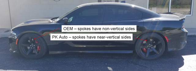

Right now, I'm running 305 555Rs on the rear (on 11 x 20 look alikes by Paul and PKA). On the front, stock rims and OEM all-seasons. For serious highway work, where rain can be expected, I have the OEM all-seasons on the stock rears that I swap on.
