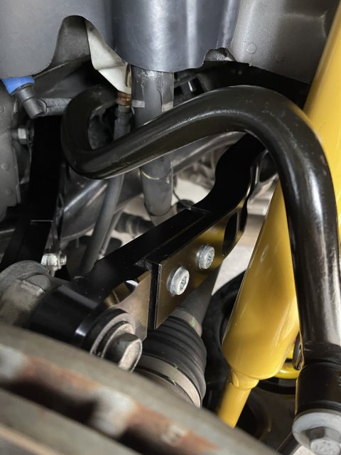

After watching your video decide to tackle the job of toe/trail arms and your video helped tremendously. Rear end feels amazing, no wheel hop. F644BC23-D692-4DAA-B446-BD7D9E2DA311.jpeg 6F374F4D-8318-402A-96CA-99F5C751AB03.jpeg 606F2107-4E50-4DAE-8CE2-3C0A7ED3012A.jpeg A9C92D0C-8930-416F-887C-7BB3A8378A48.jpeg

Recent outing I did get some wheel hop on a cold surface. When swapping tires at the end of the day I noticed the sway bar just kissed the upper control arm, presumably during the brief hop. This was with the HHP standard shortened sway bar end links. Probably not a huge deal but I don't like anything even remotely possible like that so I ordered BWOODY end links with grease fittings since those seem to insure no contact.

In the pictures above, I see lock nuts being used WITHOUT seeing any threads protruding through them which negates the locking effect. Are fasteners supplied or is the installer required to source those items? If those are suppled, someone needs to wake up their engineering dept.

Don't assume the arms come from AAD torqued to spec. I double checked on my end during my install and they were close, but not at spec. That could potentially be why you are not seeing threads poke through.
Also on the toe links, it is not hard to get the bolt out from the IRS cradle, once the nut is removed it will seem like the bolt is jammed up. Simply throw a ratchet/socket on there and rotate it until the internal flat edge of the bolt and washer line up and it should slide out effortlessly.
