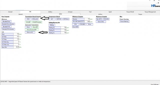

As much as I would love to be able to look I know that my Flex tune is locked which is fine because I don't need to be messing with it. I believe my E85 race tune or some version of it that I have is unlocked though. If I remember tonight I'll take a peek and check those values.

Fired up the tablet and for what files were unlocked that I have access to...it appears that both P/N and Drive AC target idles are set to 750 (752 technically) at temperature. They start much higher during warmup. 1000 to 1300 depending on temp and condition.
I may have deleted all old copies of my open tune files because tbh I messed with them too much and always went back to the known good anyways. If I can't 100% trust my guy I shouldn't be paying him to do it in the first place.

Thanks @fubar569 . That all describes my current tune as well (starts higher, settles to 752). I don’t think what he’s suggesting is a typical modification with interchillers. The owners of IC Summit/Charly have previously helped others on hellcat.org even with other applications. I wish I had there’s, but I had already purchased this one before I found out they were in the game. The AI brand for all its customer service aggregation seems to be working just (3 way bypass and comp switch all work as intnded, chiller does its thing with AC on, air is still cold, etc).. But the owner unfortunately is not someone I’d voluntarily ring to trouble shoot with. I may PM summit/Charlie on hellcat, I don’t wanna start a thread as Satera’s has a vender account on there, I don’t wanna take a chance they see the post questioning what they’re suggesting and feel slighted.

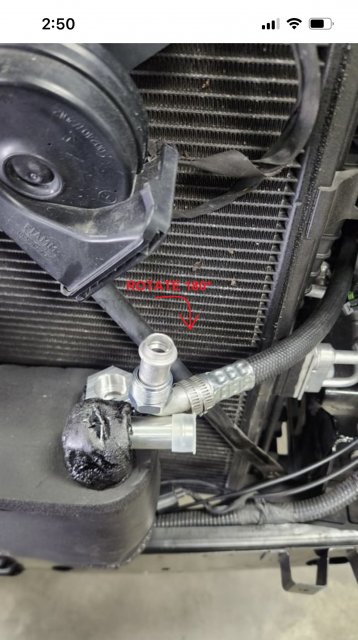

Hey all. Longtime reader of the forum..
Shop is installing this kit on my trackhawk, this is the one made by Dave Spurlock. Shop has run into the following issue, pictures attached.
The fittings on at least two of the hoses won’t articulate with the hardware they’re intended for due to the directions/angles of respective connection points.
Mr Spurlock recommended we use a vice to bend the fitting to get it to articulate with the port coming off the chiller.
Anyone installed this kit before, did you run into this and were you able to bend the fittings?
View attachment 139654 View attachment 139655
I have AI Chiller on my 2017 HC. I installed & recharged system myself and had no issues as you had. It works great.
