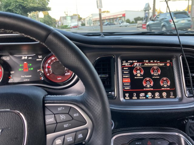

Here’s a pic of temps cruising the other day, it does a good job keeping my IAT’s in check.

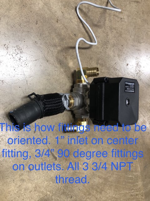

I like that set up & that's what I want, where did you locate the 3 way bypass valve ?
Active Interchiller has a similar valve, but I'm not sure where it goes inline with the system ?

Got valve from Kincaid, it can be found on eBay as well. Valve is located right off the pumps outlet between pump and heat exchanger, it’s about right behind the front fender side marker lamp. It actually uses the stock 1” rubber line to its inlet and outlet is connected to stock rubber tube that goes to the intercooler inlet. Other port on the valve feeds through a 3/4” hose over the top of the radiator under the covers to the storage tank located under the passenger side head lamp. It’s a slick installation, took me the better part of a week to do but it looks factory and done professionally.

Thanks, that helps, the AI kit comes with the valve, I just wasn't sure where it went.

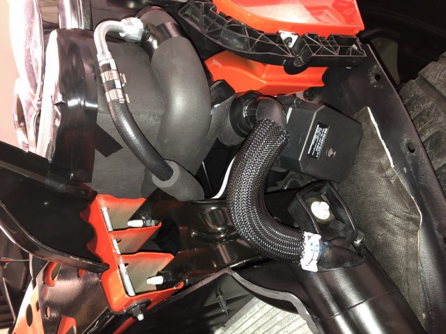

Right here, this a photo before it was insulated 661BDA4D-3E88-4531-9BB8-4E237E43477C.jpeg
