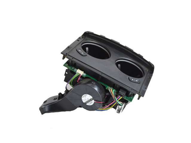

When I picked up my 2016 HC Charger back in March, I had read there was a simple upgrade to add heated/cooled cup holders (Part# 1PB67DX9AD) like those seen in the 300C. After some research, I found what I needed and ordered and installed the cup-holder for my car. For this mod, the Red (heating) and Blue (cooling) rings do not light up when the cup-holder is on. The normal ring illumination works when the parking or headlamps are on though, but that is turned off when you place the cup-holder into either heating or cooling mode.
Just a note about this mod. It is plug and play on vehicles which have heated rear seats. If your car does not have heated rear seats, then you will need to power it with switched +12V (orange wire on the cup-holder).

Any advice for 2017 Charger Hellcats? I see a different part number when I look at the 2017 Chrysler 300 part (5PF37DX9AA). Looks like it has an air duct that ties to the A/C air duct that runs under the console. Did yours have that?

I would google 1PB67DX9AD). That is the p/n for the one I used. As far as that duct, It’s just an air intake and fan assembly that gets air near the floor from the side of the console next to the driver’s seat.There is actually a bump out or notch on the bottom side of the console to keep the console side from being tight against the carpet. It does not get cold from the A/C. It has it’s own coils or something like coils to make the metal cup holders hot or cold. It works whether the A/C is on or not.
Yes, mine looks exactly like the picture.
