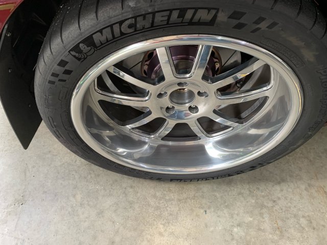

Look at what the UPS fairy gave me! Just got the monster all cleaned up. What a great morning!
