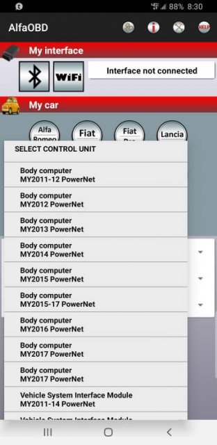

Tap SELECT CONTROL UNIT and choose your MY Powernet.

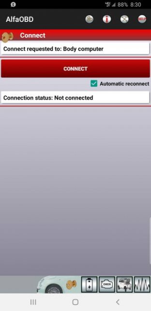

Click CONNECT

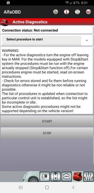

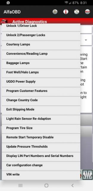

Click SELECT PROCEDURE TO START

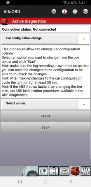

From the drop down, select CAR CONFIGURATION CHANGE
Click SELECT OPTION
Scroll down to DOORS - GLOBAL WINDOWS DOWN
tapatalk_1567400575761.jpeg Select YES and click START once. In the information box, at the top, the current car configuration will appear. It will tell you if your car is set YES, or NO, or whatever variable you can choose from.
