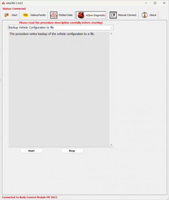

First, DO NOT HAVE ANYTHING OTHER THAN THE BLUETOOTH MX+ OR SIMILAR DONGLE ATTACHED.
Second, make a backup, connect...
Head to Active Diagnostics and then selected Backup Vehicle Configuration to file
30 seconds later:
Now... YOU ARE READY TO FUCK SHIT UP ...
