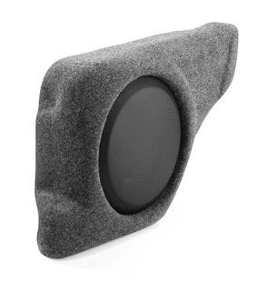

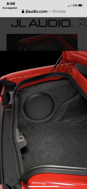

Just like the title reads, anyone have any experience with this subwoofer? I bought the Performance Spare Tire kit, but still have the factory subs in the tire well and keep trying to find some subs custom fit to the car, so I can mount the spare where it belongs. Any opinions? 7DF586D4-D243-480B-9B02-89389B094B73.jpeg 0B7FC7DB-97B3-40A6-9B4E-EBF11F0658F7.png

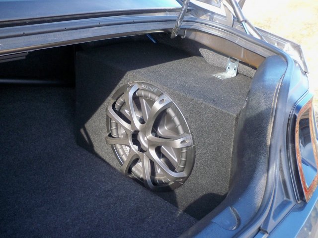

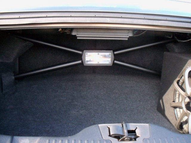

I found a box made to fit my last Mustang and put in a 10" Kicker. So there may be more options
