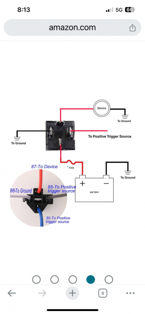

@2ndAmend so I’m good with my description above? Just want to be certain. Thanks
The number of pins does not matter, use the ones you need. I think the 5-pin might be the most common these days.
Just use 30 and 87 for the lights, one connected to +12v (fused), the other to the lights.
Use 85 and 86 for the switching coil. Normal would be for the switch to provide +12v to one and the other connected to ground.
When you hit the switch, 85 and 86 will energize the coil and the relay will close the contacts connecting 30 and 87.
