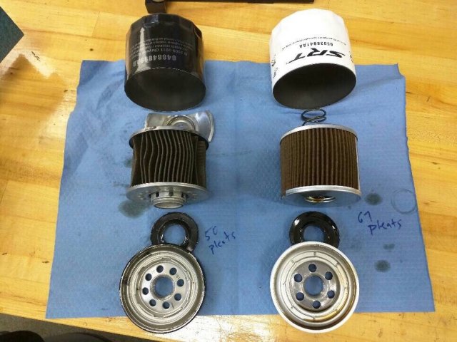

I have been shopping around for oil and filter. When I search the SRT oil filter I get the notice it is not for my 2017 Hellcat and instead refers me to the black filter. I was under the impression from other posts that the SRT filter is preferred by most. Any input would be appreciated as I have extended warranty on it and dont want to do anything to give them an excuse not to honour it if issues should arise.

The SRT filter is considered to be the better filter, however I've seen the statement from FCA that it is not the "correct" filter and is not to be used. :rolleyes::sneaky:
With that said, use at your own risk.
I use the SRT filter and get my oil analyzed, the results show excellent filtration/wear. However I also change my oil on a crazy short mileage basis (6months/racing event instead of 3000miles). So keep that in mind.

I have to wonder what the difference would be in flow rates between the 2 filters? My car will only see 3-4000 miles during driving season then will have an oil and filter change before its long winters nap......I hate the thought of that....
The Other place has an old thread on the differences, including flow specs, between the two. Finding it might be challenging.

Do you remember what the outcome of that was? I thought the white was actually superior but I could be wrong.
@rayzazoo was behind that if I recall correctly, SRT won out pretty clearly.
But like most things back then, and like now, there was much "debating" over it.

I did a little Googling this morning and found these 2 items;
041AA Filter -
"For track-day use, SRT engineers suggest using the SRT oil filter (part number 05038041AA). Originally designed for Viper applications, it works great with all Chrysler V8 engines."
This information was sent out in a SRT news release and was publically verified by SRT engineers, and confirmed during a SRT Engineering chat session. The 041 is a factory and certified Mopar part.
"The SRT oil filter for all the past engines and the new 22mm inlet SRT filter for the Gen 4 and beyond engines share the same characteristics.
We worked with many of the filter suppliers to get the best features. Some fell out for various performance reasons but we ended up developing the current SRT filters with one of the mainstream manufacturers (it is different than their commercial offerings - or at least was when we developed it). The high flow oil pumps in our large engines (Viper is the biggest) can overpower the internal relief valve. When this valve opens it allows some of the high pressure dirty oil to bypass the filter element in order to keep the filter from being damaged. The SRT filters do indeed have a higher differential bypass valve to make sure all the oil delivered to your powerplant is clean. The housing is slightly thicker than many of the brands out there to handle the pressure but is not the thickest. The real thick ones failed our development testing (fractured at the crimped flange). The media used was one of the latest synthetics that allowed very fine filtration, more debris capacity, and much lower restriction than our standard Mopar filter (and just about every other filter out there). The final result was clean oil to your Snake, all the time, with more pressure to the internals where it is needed. I would fully recommend using this filter in your beast, I do in mine. Hope this info helps. KCC"
I think I’ll go with the SRT. It’s like adding a catch can, you don't need it, it just makes sense. Thanks for the input gentlemen.
