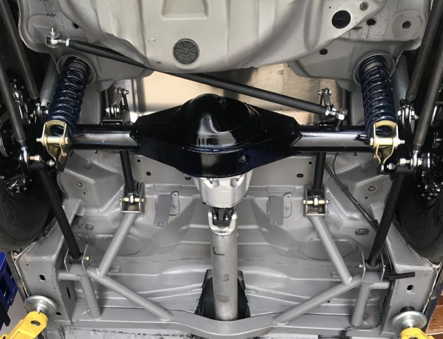

Every time I’m on the floor under the car it’s just so peaceful I start feeling like I want to take a nap. What’s this deal with cradle lockouts? 😝 B760FDE7-B8F4-4056-AE7A-C82A25B3453A.jpeg

Every time I’m on the floor under the car it’s just so peaceful I start feeling like I want to take a nap. What’s this deal with cradle lockouts? 😝 View attachment 77896
that looks like a dream so maybe you were asleep
