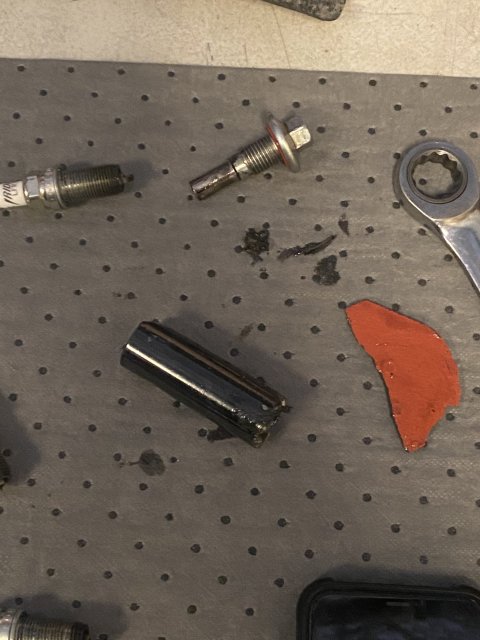

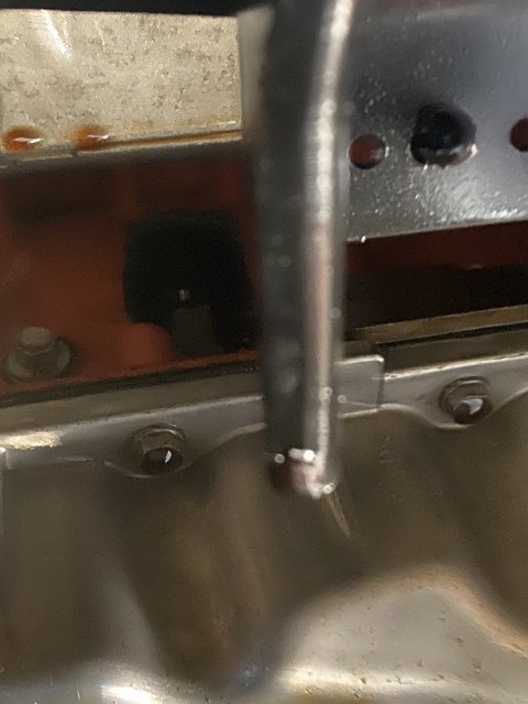

Wasn't sure what I'd find. Was HOPING for a head gasket but never heard of a stock engine hellcat blowing a head gasket. Figured it was a piston. Started looking this morning........
I did some research over the past couple of days and read that at a certain power level, the small end of the connecting rod will let loose at the wrist pin. I figured I had a ways to go before I got to that power level. Guess not.
Also, the required engine diaper did exactly as it was supposed to. I had zero idea to the extent of the damage as other than the smoke out of the tailpipe there was no oil anywhere. It sat on the trailer from wednesday until yesterday with no oil other than from the tailpipe. I parked it at the lift yesterday, and this morning when I picked it up saw a small puddle of oil. When I started to drop the diaper, it was full

Had it not let loose I might have had to start looking at parachutes (car 374)
I have a spare block so I was planning a 411 or 422, but if my crank is still good I’ll likely do rods, pistons, cam and have the heads ported then put the nitrous on a stand alone tank

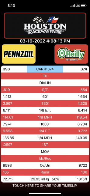

One dyno had me at 898 blower only.
the one I normally use had me at 839 blower and 964 on 100 shot.
After reading about the wrist pin end breaking I’m thinking the dynojet (898) was closer to reality than the dynocom (839)
