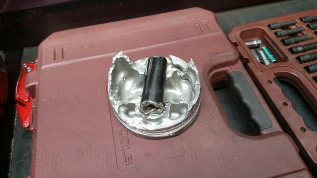

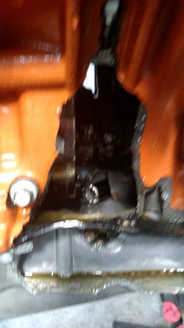

Hellcat, Demon, Trackhawk and project X,
Pistons are weak on the Hellcat, mine did the same thing on a 8 second pass (well it ran 9.2 or 9.3 I forget) with a hole in the block. piston.jpg
