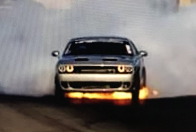

So what was the white/light grey smoke after the failure? I am no expert on blown engines but I was confused. Usually water evaporates and dissipates almost immediately, this did not. And oil is usually smoky bluish. Any ideas?
The cloud of death is always white ☠️ 1AF02B60-4406-4459-8F04-3C8C43F18742.jpeg
