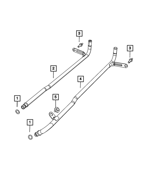

So this is odd, this is the passenger side heater core pipe. Anyone have pictures of their front cover/valley where this goes in? Very strange, something’s missing
7000 Posts Club
7,880
6,745
Thread Starter #28
I’ve had the supercharger off a million times and never noticed this. Why is my front cover missing the nub for it to bolt onto

This is an early 2015 m6. Anyone else have one and have pics of their valley? This is weird. No idea how I didn’t notice it when put the 2016 hard pipes in

I wonder if @fumanchu182 remembers if his didn’t have an extra nub on passenger side to bolt to
3,949
9,760
I have no god damn clue what you are talking about.
6,974
18,013
I think he's expecting a threaded boss to be where that bracket with the hole in it is to bolt the heater pipe to the block and or timing cover.

Is that a factory hellcat timing cover? Every hellcat I've worked on has a 10 mm bolt to hold that on.
Yep, factory.
RGPIII
#983
1,081
1,982
Bridgeville
DE
both tubes should have a mounting bolt to hold them in place on the timing cover.
3,949
9,760
as per mopar notice the passengers side doesnt have a tab, wonder what year this changed. Also the catalog has the wrong part identifier. Its all screwed up.
7000 Posts Club
7,880
6,745
Thread Starter #40
Well, my car is an early 2015, and the hard lines are from a 2016
