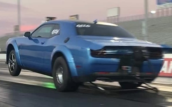

Ok. 1.18 sixty (with the rear wheels) 8.09 blower only 😘 5DE3C8BC-18F2-48BE-B2C7-BA0B10D9FEC4.jpeg
