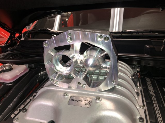

They are set up stock yet and very sensitive, I’m hoping that’s what was triggering them. While off and apart I opened up the inlet to match the BBK 100mm TB that’s going to be the next addition. It’s a hair under 100mm as I wanted to retain the factory oring groove but with the BBK attached it’s a near perfect smooth transition from T to snout. View attachment 36443 View attachment 36444 View attachment 36445
I've contemplated doing this as well. Did you remove the front bearing plate and do any work there?
Starting and ending grit?
Did you consider an smoother finish? (Polished)

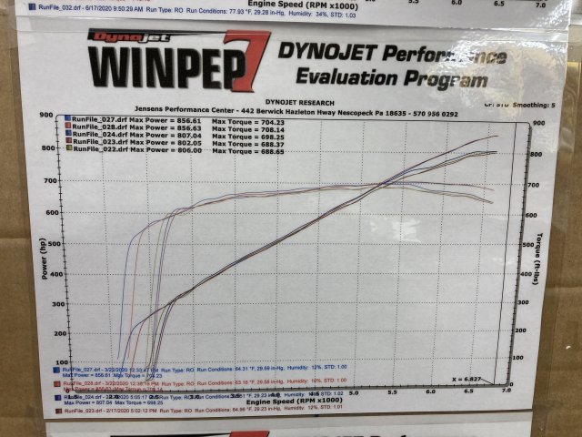

I used a FAS plate, ruined my original blower the first installation because the bearing bores where too tight. Gained a Dyno proven 50 hp with it though on the second blower, luckily I had a new spare blower in a crate on hand. This dyno graph is before plate and after plate. I also port matched image.jpg the stock snout to the plate and added a fast man true 95 mm throttlebody.
AD11CB0F-CB94-4D06-B0A0-D1F5CE373BD3.jpeg BB56B9BD-54BD-4DAC-9CAF-6FAD7086C7D5.jpeg
