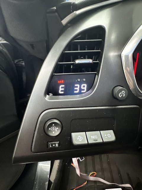

Yes it does. I run my challenger on e all the time. My z06 also and next will be my c8. I have stations all would me with it.
my GNX has been on e from 2006
