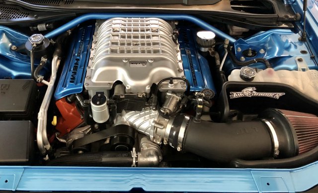

That is what made me look last night. I was having a conversation with a man who watched a video. He was almost persuaded to begin a big project on his Redeye. My example shows how a simple can connected to the drivers side works pretty darn good at least on the engine that I have. Consider the multiple HPDE sessions on six different days, running the car to its limits at WOT, and only catching about 1.5 OZ. We have to be much harder on them on the road course rather than WOT for 10-15 seconds at a time drag racing only.

Mine does. Most folks use them on the p/s side and seem to get results with minimal result, if any, on the d/s. Here’s my JLT. 3ED21690-46D4-43A6-93B3-5576E69CB310.jpeg
