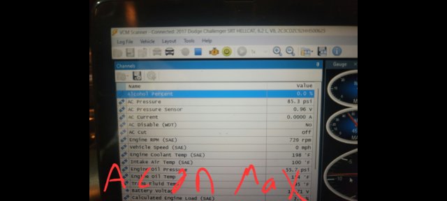

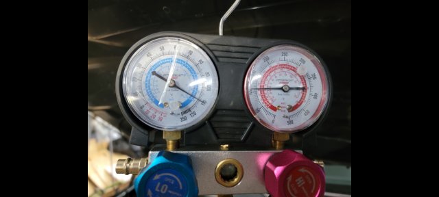

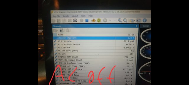

AC on, everything spins.
AC off, the clutch stops spinning
Attached are two pictures of the Gauges. One with ac on and spinning. One with ac off and not spinning.
Same thing if i unplug the pressure switch

Bare in mind this is only with 2 cans of freon in it after vacuuming it down. I got 2 cans in and saw the low pressure side jump high so I stopped.

Pictures worth 1000 words. You can see where were at now.

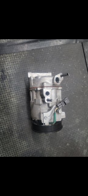

Fresh compressor in the AM. We shall see.
