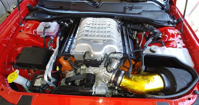

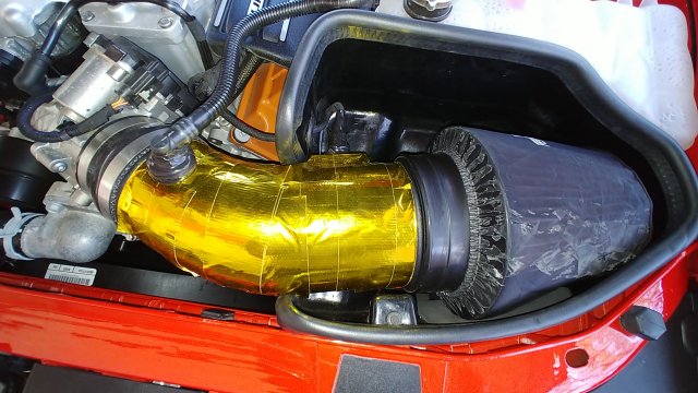

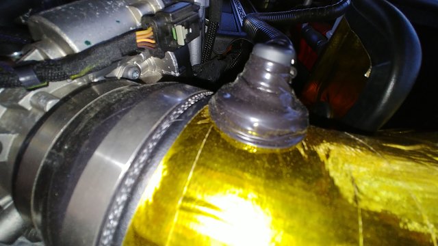

I replaced mine (a 19) with a JTL.
Much cursing. They aren't made to go on 19's.
4,679
24,285
Pictures plz.
9,067
23,951
9,067
23,951
9,067
23,951

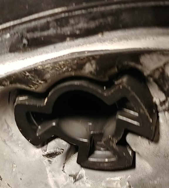

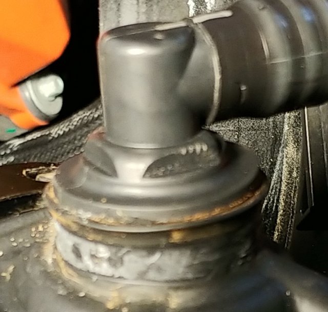

The part not made for 19 CAI's.
9,067
23,951
What the 19 stock CAI looks like.
And what it looks like on inside of tube.
Have to cut the ears off to fit in the JTL tube.
