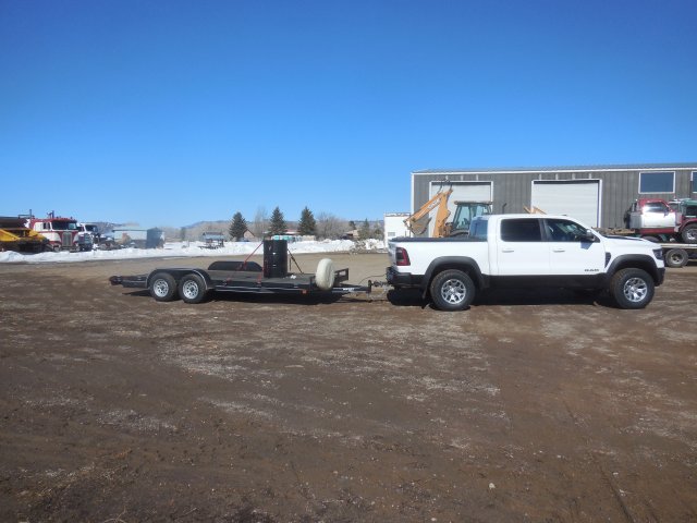

Against better knowledge, curiosity got the better of me so I did try to tow with the new 1500.
It did better than the old one, but that's really not saying much. It was still very obvious that the trailer was back there. Yes, the drum was full, so there was a little bit of weight involved. Enough to sag the rear a couple of inches. DSCN4290[1].JPG

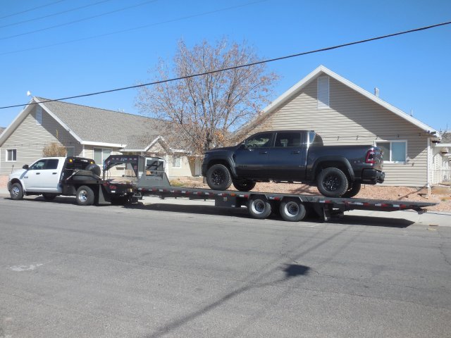

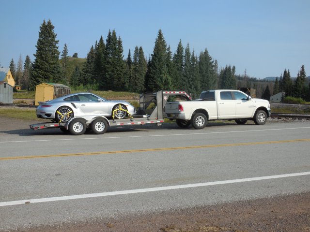

I've given up on bumper pulls, and 2500s.
These days, if I transport a car it's on or in one of these. DSCN2158.JPG DSCN3790.JPG
And yes, that first photo is indeed a 2500. But my girlfriend has since traded for a 3500 longbed.

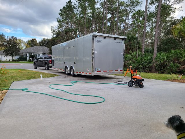

My 2500 does fine pulling this with the Charger in it and the gear. If I'm not careful, I'll be doing 80. 20220111_152616.jpg

That was the problem with her 2500. It had 3.42 gears, so you had to do 80 or better to keep it in 6th gear.
But she doesn't want to go nearly as fast with her horse trailer.
And 80 happens to be my preferred speed with my 3500, but that's also at 2,000 rpm. Which it really likes, by the way. Realistically, I should have 4.10s for the weights I pull at times, but then I probably would end up going slower.

Mine has 3.55s. Nice highway gear. My loads are pretty light compared to most.

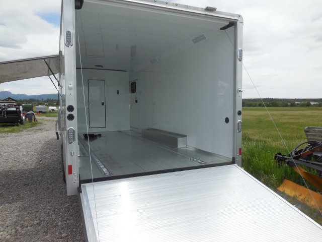

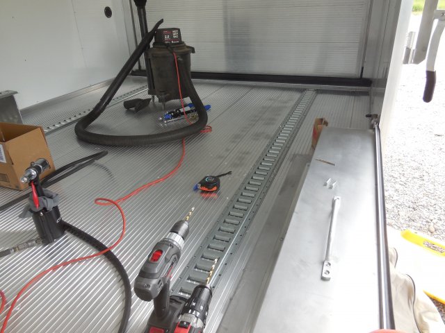

Here you go, Magnified.
This Sundowner lent itself really well to full length E-track as the floor is aluminum profiles.
I could put bolts through the cross members every 12 inches, then rivet all the other holes.
And as luck would have it, after making a decision on the width between them based on the track width of a few vehicles that could be transported in this trailer, it matched the factory tie-downs perfectly.
Looked at regular enclosed gooseneck trailers the other day, but damn...a little 24-footer cost about as much as I paid for this 38-foot living quarters version about three years ago.
