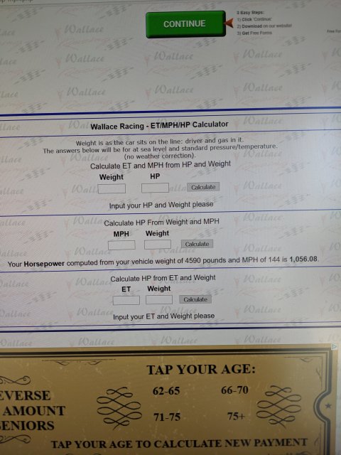

Hey Speedy,
Run this through your calculator and tell us what comes up...
How much power does a car that weighs 4590 lbs with driver, runs 9.73 in the quarter or traps 144mph+ make?
This should be good... lol

4,525
9,396
Does the amount of timing the car will take also depend on the RPM it is being run at? The ceiling for RPM dictates the ceiling for timing, no?
And, FWIW, it's roughly 1000chp to run 144mph @ 4590lbs.
Is 200chp a lot of gain when you're running high octane at high rpm with a lot of timing? Yeah, but not unreasonable.

Regarding these calculators, when I type in 144 mph and 4590, it show s 1056 chp. That's over 250chp more than the same cars factory rating on 93. It's over 200 more than a demon rating (same engine) on the factory race gas tune. The factory race gas tune runs about 6 degrees more timing than the 93 tune and only produces about 40 more hp. Based on the theory that more timing could create all this power, you would need another 24- 30 degrees of timing on top of what is already there. IMG_20190911_122113.jpg

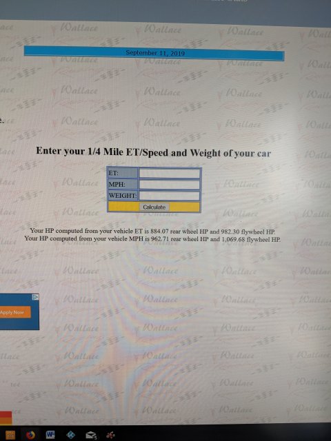

Here is another calculation from the same site using 144mph, 4590lbs, 9.73 et. It has calculated both flywheel and rwhp. 962 rwhp on any stock boost car with any amount of timing at any rpm is hard to believe. Lots of pullied cars can't make that power.
Entering in the actual mph on the slip of 144.83 shows 979.45 rwhp. Either everyone else is artificially Inflating their power numbers to make their cars look good or this calculator is way off. Lol
