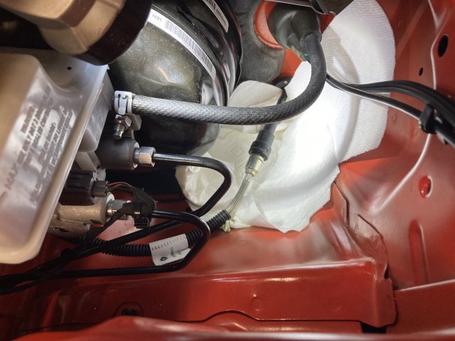

It’s easy to see, right below the power brake booster. The new one is for all model years, exactly the same as my 16 original.

Here it is in the line before I took it out, the paper towels are just there under it to catch the brake fluid that came out which was just a couple drops. See the brake booster to the left? It’s right there in the corner next to the firewall.

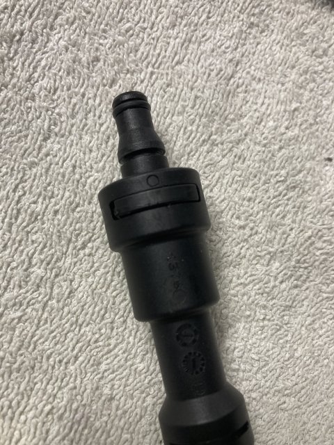

Being I won’t be running for a while (heads still at Thitek) anyone want to remove theirs and see what it feels like? The hose won’t reach with out the black thing, the valve, there but I’d be willing to mail someone a gutted one to put in the place of the stock one. Anyone game? It’s super easy to get out and back in once the cowl is off, which takes about 20 minutes, no special tools required but a push pin removing tool helps get the push pins out across the strut tower brace.
Anyone? Or just remove yours, gut it and put it back in and test the difference. It’s easy to put the parts back inside it and nothing is ruined, it comes apart by removing a plastic clip just like removing the hair pin clips to get the clutch line out of the HRB fitting, all those connections are the same right to the master cylinder.

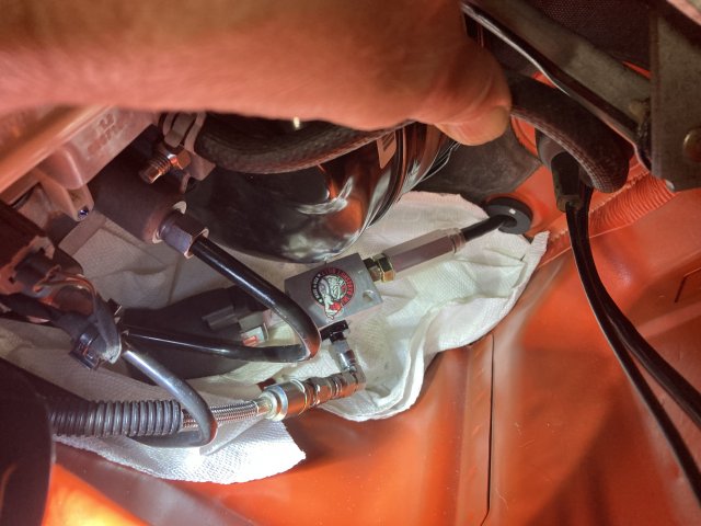

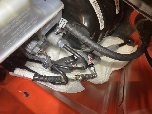

Here is the BSB plumbed into the clutch line minus the CDV. Notice the paper towels barely have any fluid on them, I had it apart 3 times and only a few drops of fluid lost.
947EBBE8-7E06-41F2-8505-151721B5C4B6.jpeg 3FCB9A8D-F9F8-4832-B11F-9B7760B663C4.jpeg

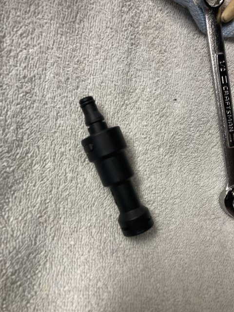

Here is the CDV by itself. See the slot, that’s a plastic U clip that holds the male end inside the unit and keeps the guts inside. Pull out the clip, pull male end out of the body, the 4 pieces come right out, put the male plug back in and put plastic clip back in, gutted CDV, put it back in.

Yea, winter here too. I can still cycle the clutch once it’s bled and I’ll know a bit by how hard it slams up or not if it’s going to be too wild or not. I have an email out to BSB asking his recommendation on whether to remove it or let it in place but as you can tell I plumbed it without it expecting his answer to be remove it. It’s easy enough to put back in. When my cars back running I’ll just leave the doors and cowl cover off during testing as I don’t even know how if I’m going to like the BSB or not. It’s 900 bucks so if it’s a 👎 off to a buddy or eBay it will go as the mustang guys like them. It can be turned off completely and act like it’s not there for normal driving so we shall see. It took a 9.5 PB stang to a 8.95 PB on its second pass of use so have high hopes and expectations for it. 🤞🏻🤞🏻

I’ve had my cat out a few times now with the real CDV removed. NO MORE START OFF CHATTER FROM THE RXT1200 HD !! Like night and day different on ease of a smooth start off, no more shudder!! I think the shifts grab quicker too, the other day on a 60-130 run she broke loose when I banged 4th, doesn’t usually do that, could be cold roads too. But I like it with it gone, it’s staying out.

Yes, shifts are more harsh on the driveline now, but quicker in applying power which means your clutch discs are not being asked to slip (and wear) on hard shifts and quicker now (all be it by fractions of a second only). Everything comes at a price.
