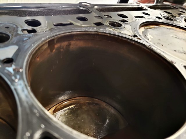

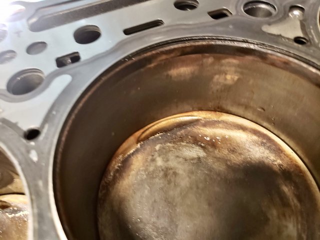

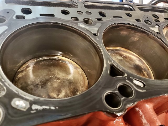

My 2.72 has shown 17-17.5 in good air 16.5 in not so good.
Head gasket?
No, I can only assume a lot of condensation for sitting for almost a month and only getting started to move in the parking lot or around the shop.

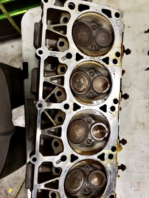

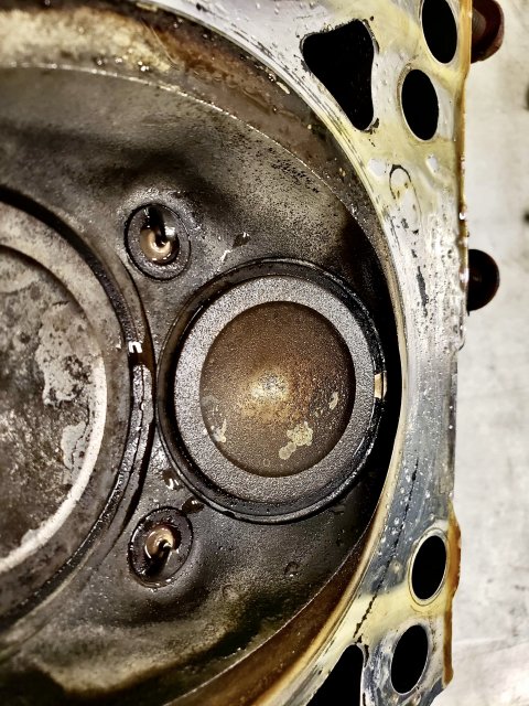

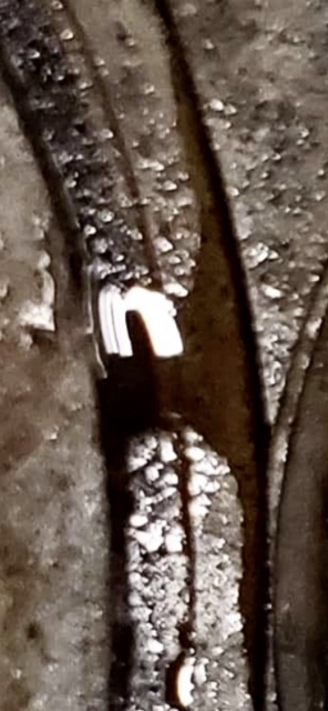

am I seeing that right the valve seats are damaged???
Heads look good from what I can tell. I've been on e85 for a long time all seasons of weather too. Not sure if it's worth doing a tank of 93 now and again.

Looks to be just a water drop when you zoom. Good eye though.
3,309
5,756
Ok from the pic looks just like valve seat bad lol

Honestly, I don’t see anything wrong with those pics. I’d be surprised to see excessive wear on the lifter or cam at this point too. Some wear, ok, but doubt it’s severe. Did you drive it at all after the dyno session?
