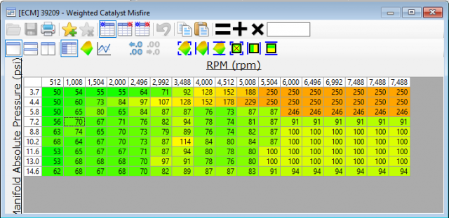

As the current cylinder #8 misfire record holder it is comforting to find out that these are not issues just related to my car. The Hellcat sees about 26PSI of boost in good weather. Misfires are turned off.
Map based table:
Load based table:

@fumanchu182 how are those misfire tables to be interpreted? Above those values sets a code or ? Is it cumulative or time based?
