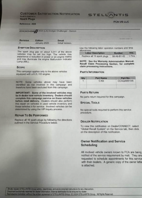

Interesting...looks like there's now a full campaign on replacing the plugs in all Demon 170s. Couldn't find anything on the replacement PN on Google, maybe because it's a kit. Mine's never had a problem, but I'll get this done now that it's a thing.
Shows a shop time of 1.7 hours so all these stories about plugs being hard to change must be folk lore :LOL:
1,593
3,971
I would buy a ticket to watch a dealer tech R&R all 16 plugs in 1.7 hours!
Yeah, either laugh at the real hours, or learn some impossible secret to doing it.

That for sure would be worth the price of admission 👍
Exactly. I have no doubt the OEM engineering behind the PCV system on the 6.2 is sound, but if it weren't for those damn humongous China Walls on the valve covers, I think the job would be so much easier. Every time I look at one of my 392s and then the Hellcat, I just shake my head. I have been pondering if a set of aftermarket covers and figuring out how to keep the system plumbing and catch connected would fit and work.

Well, the stated 1.7 hours is kinda good news. While I enjoy working on my own junk, I don't enjoy an 8 hour day leaning over an engine bay fighting with something as simple as spark plugs. Labor rate X 1.7hours makes it a no brainer to have the dealer do them if you have a good tech you trust.

1.7hrs is a joke that I will pay good money just to laugh at.

Here lies the problem

If you find one let me know 😯

One of my good friends is the master tech at my local dealer.
62,130
217,019
Here is my guess, they don't unplug the coil packs. I have on a couple laid the coil pack aside and changed the plugs. My biggest issue is getting them unplugged. Spent too much time trying to unplug them first not seeing if there was enough wire to pull them out plugged in
My next plug change will happen with the engine out so may be awhile before I can test that theory

Yes, there are actually two techs at my local dealer that I would take my car to with no hesitation.

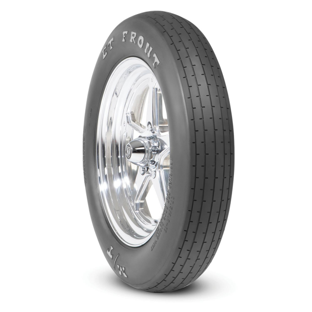

Time for new front runners and trying for something lighter weight than the M&H. This will be for track only unless I'm required to do some kind of 30 minute drive as part of a race event.
I was looking at the Hoosier Drag Front like this one: https://www.jegs.com/i/Hoosier/522/...PvLcDkIDdGeN0XR4FSKyPJ3lO-LVsomUy8gZDF0r9tgjY
Crew Chief Greg said to also look at the Mickey Thompson ET Front: https://www.jegs.com/i/Mickey-Thompson/672/30093/10002/-1
I know several run the Hoosier. Anyone have experience with the MT? The OCD in me would like the brands to match front to back, but I can get over it if the Hoosier is the play. NOTE this MT Front is not the Street Front radial, it is a 12lb bias ply front.

Are those 15s on the front?

Link says 17x4.5
I could have picked up a new set of the m/t for $300. Decided i wanted the radials. Seemed most had the Hoosier billet specialties set up at demon race

The Street Front is a nice front runner, but I'm going for max weight reduction and they're 16lbs vs 11-12lbs for the bias Hoosier or MT from what I'm finding.
