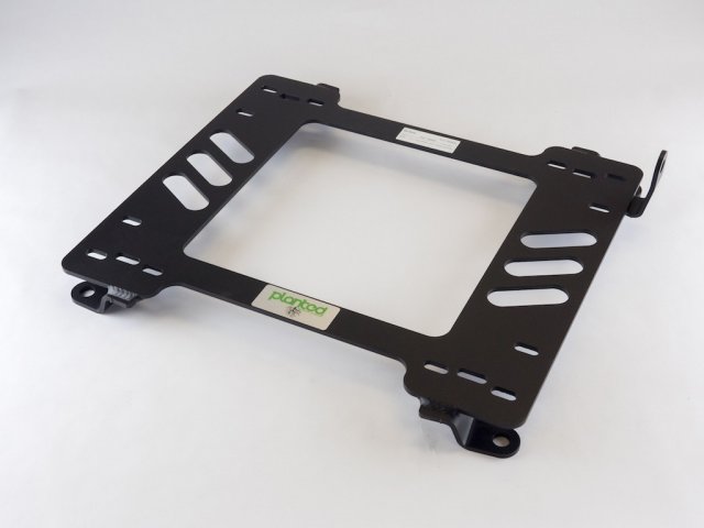

I really like that Kirkey seat mount! What is that?
That setup ready to bolt in including the seat belt buckle and seat belt guide is a total of 21.8 pounds. The base and side brackets are made by Planted. But that stuff is HEAVY. If you think about it the 68 HEMI Darts only had simple side brackets made out of thin aluminum that boilted directly to the floor. This setup is WAY stronger (and heavier).
Steel base and aluminum side brackets.
. After my work.......
Also I used all TI bolts and I drilled the 1/2-20 Seat Belt Buckle bolt (could not fint a TI one cheap enough).
3,626
11,698
I thought that looked like the planted base. The side brackets are bitchin! Yea that’s heavy. I had a set of custom brackets made by Carlin Fabrication there in SoCal (they did the cage and suspension) and the whole seat with cover and bracket combination is only 23 lbs all together. Thanks.

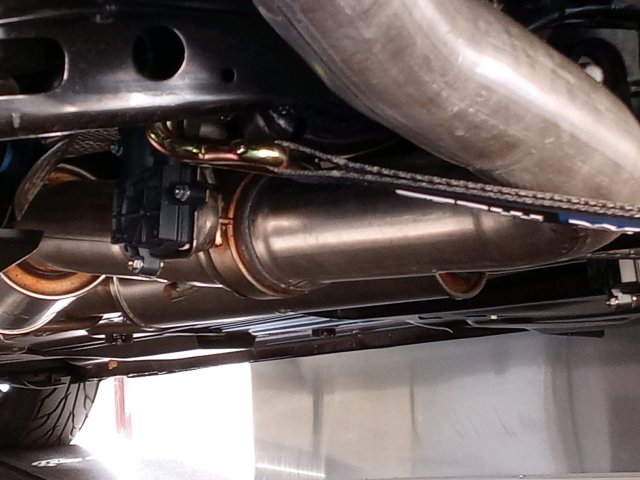

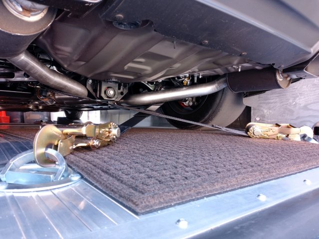

Correct. I have been using many methods over the years. I have settled on a tie down with a snap hook where it attatches to the floor and a Double wire hook facing up where it attaches to the car. It does an excellent job of cross tying. I attach to the K Member in front just outside the rear corner of the rear splash pan. In back I go into the hole on the bottom of the LCA near the inner bushing. That wraps slightly around the exhaust pipe. It also crosses real well. I get everything good and tight. I used to baby those straps but now I tighten the crap out of them.

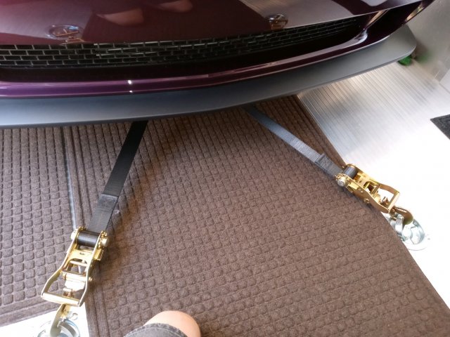

On the front I got rid of the snap hook and forged mini-J hook and now use a much simpler double wire hook working end facing up.
