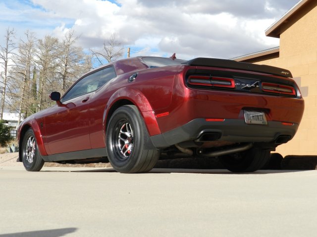

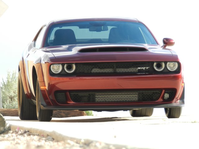

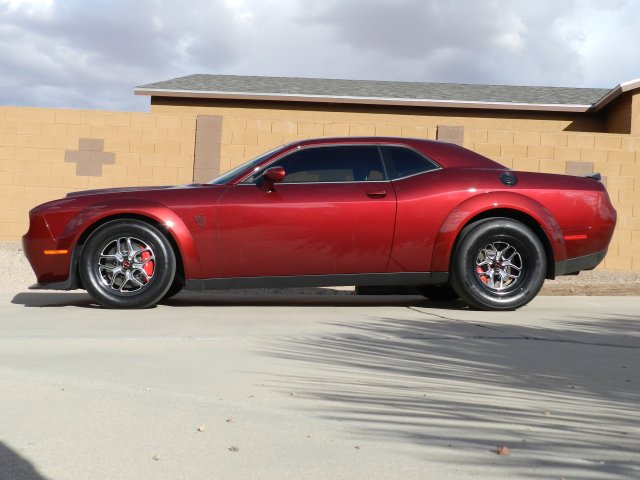

OK, I had this car I am working on out today for a test drive and to take some photos. 315/55R17's on the back.

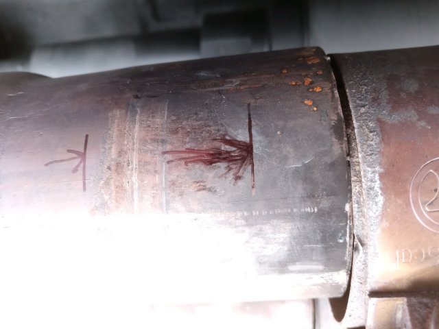

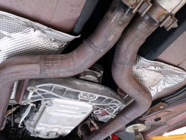

I also need your help. It has catless mids on it and as far as I can tell they are JBA. Each pipe has 2 welds in it so 3 sections welded together. I had these on my Hellcat and we have them on the Blue Demon. No issues whatsoever. On THIS car the pipes are about 1-1/2" too short. Scratching my head on this one. Anyhow I am looking for a set that will fit properly if anyone has any. NIB if possible. I prefer they do not have adapters. So stainless works are out. I think my first choice is American Racing Headers Catless mids. 1010221449.jpg
THIS PIC: The line on the left is with the pipe inserted all the way. The line on the right is where the pipe hangers are nuetral (hanging straight down). The difference is how much longer they should be.
