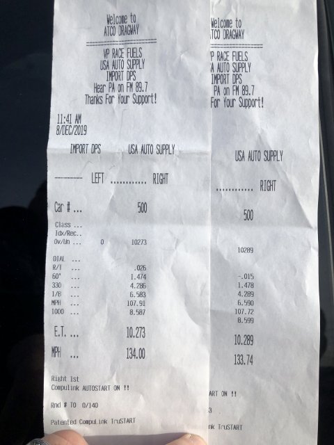

I will try to add another data point in to help, my hearing is terrible, but I do notice the same slight hesitation, but here is the video, and the time slip from a run late last year, and a follow up run. The car is stock, with MT 305/45-17 and skinnies on the BS wheels
Damn that was a sweet run! She hooks and books...GONE!

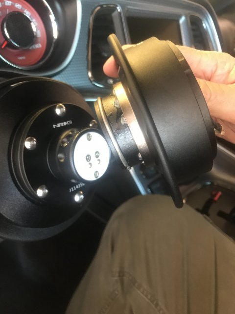

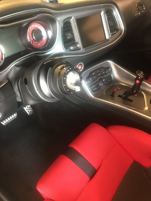

Too late. I’ll just remove my steering wheel instead. 😝 View attachment 18007 View attachment 18008
Nice! So you did end up finding a NRG quick release that worked(y)[/QUOTE]. Sorta. I took a chance on what they had listed for the 2010 thinking the spline/shaft configuration might work. It did. It’s unchanged. The hub itself though won’t fit over the new clock spring housing so I had to remove that. That means for the time being I won’t have the turn signals. They said that they will have the new one in the future. When they do, I’ll Spend the $100 for one of those and put the clock back. While all this seems extreme, in reality, I can put the whole thing back to stock for street driving inside of 5 minutes.
