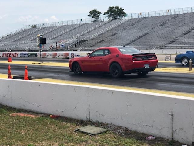

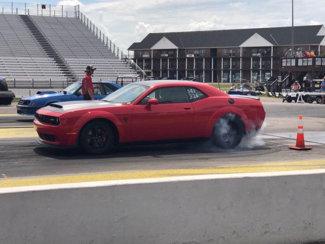

Down to the wheels. View attachment 19889
What do you run with your bone stock Demon? Assuming you are on the race gas tune/crate air filter and use the front skinnies? Ever street drive it, or race it on pump gas and regular tune with big front tires and regular filter?
Passengers seat cloth.
Safety harness and bar.
Off foot brake at dead idle.
1300 DA.
Never driven with rear tires up front.
Air Grabber race filter.
3600 miles.
1,934
3,869
Nice! 10.0s@135+ Is haulin! Car looks awesome on the strip. That’s race gas/race tune with front skinnies then? Crazy to think easy driving street legal cars can do things like this on the drag strip!

260GT Sunoco.
Never ran nittos.
Just a bracket racer.
