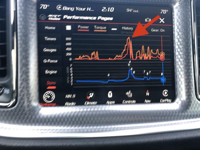

Thought I’d share this. 2019 RE (bone stock except tires Michelin PS4S, 3.09 gear, no weight reduction) and I’ve experienced the 1-2 & 2-3 shift hiccup on occasion. But the other day I experienced a big hiccup (in D, paddle shifters off, trans set to sport, 4 gallons of 100 mixed with 91) when I mashed the pedal at 60-65mph. Car basically shut down. Picture is a little blurry and gear markers are on, so you can’t see what the RPM when the hiccup occurred. You do see the engine torque and HP drop sharply though. What I think happened is the car down shifted, then over revved itself and shut down to save the engine before kicking back in. Haven’t had a chance to take it to the dealer yet. But I agree that there are some inconsistencies with the factory tune when there should not be. I’ve brought up the shift hiccup before with the dealer, so it’ll be interesting to see what they say this time around. I will say I am glad the car didn’t decide to commit Hara Kiri and blow the engine. 7815803C-E854-4487-B85F-BF40D736AECB.jpeg
